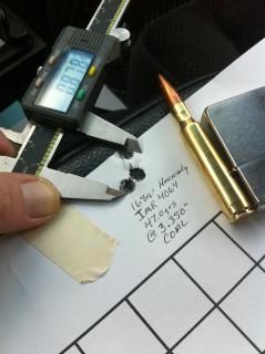

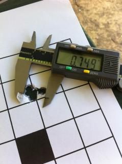

        The bedding (in-letting) still needs to be improve. Loaded several of the 168gr hornady Match with 47 gr of IMR 4064 COAL at 3.350″ after spraying shotgun patterns I shimmed (.020″ paper giving 9 Lbs of pressure) between the front pressure point of the stock and the barrel I was rewarded with the following group

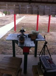

        .878″ outside to outside was not bad considering how she was performing earlier. A Three shot group which is nowhere near giving real good clear results as to how she will shoot.  But without wasting any further ammo because she is not bedded correctly and the groups was so terrible at 100 yards I shifted back to the 50 yard line to work on the barrel pressure point. While attempting to figure out what the rifle was attempting to tell me so bear in mind all groups that I am showing are at 50 yds.

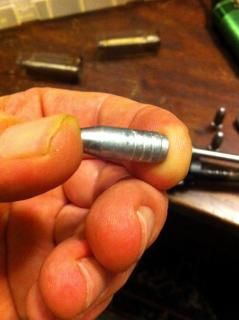

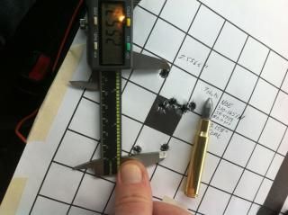

        I then loaded the NOE 310-165 FN with 20 grs of SR 4759 with a COAL of 3.158″
        The next loads was again the NOE 310-165 FN exactly the same but 21 grs vs 20 grs. but I want to show why a three shot groups does not tell the story here is the first three shots:
        three dead in the same hole amazing right even at 50 yds but now “for the rest of the story” as somebody used to say
        All in all not a bad day , positive results was had
        now to git her to bed properly and ensure at least 9 lbs of upward pressure at the stock ferrule (aka pressure point).
        This will be a ongoing saga in order to get some good results for a friend

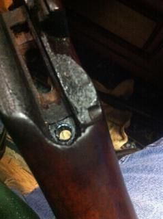

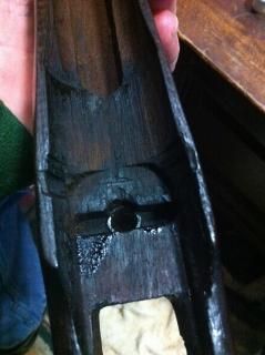

                        I’ll attack the front stock ferrule under the recoil lug that should apply more pressure at the Front band’s pressure point. I might have to lengthen the rear tang stock Ferrule or I could just gently work the wood down and adjust the ferrules from there.
                        Just realized I do have photos of the ferrules her ya go:
                        Front (recoil area): IMG_0817.jpg note the little bit of prussian blue on the stock just behind the recoil lug on the left that is all the contact with the stock. the metal ferrule is holding the bottom of the receiver from contacting the wood.
                        Now the rear tang ferrule: IMG_0818.jpg

                        Edited to add:
                        Here is the tang shims that was used by Remington during war time production usually with the 1903 A3’s
