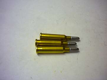

      Wanted to see if we could do it more than anything.
      Have a Contender in 17 Ack. Hornet to try it in.
      Not expecting a lot but should be fun to see what it will do.

        Did some speed tests today with (94/3/3) hBN coated.
        At 1875fps they still shot fine but at 2040fps they scattered bad.
        More tests to follow.

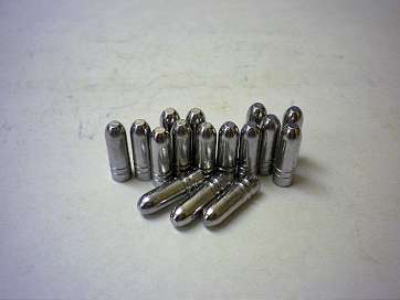

          AlvinYork
            Speaking of gas checks, could you use a 22 gas check as a 17 PB for this bullet?
            A 22 gc is .214 or thereabouts leaving .042 as excess giving a wraparound the bullet of .021 all around.
            Looking at the bullet drawing it seems like it might work, if you use a thin enough material. Copper foil or soda cans are my first thoughts.
