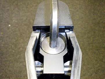

                Had a little time to play with the bulldog last night.
                Wanted to see what adjustment was with the hammer spring.
                It has real easy accesses – remove the butt cover about like a
                Tupperware lid and use a 1/4″ Allen wrench to turn it.
                Stock mine was set about flush with the housing.
                Tethered the gun to a 3000# scuba tank and shot 5 shots with
                each full turn of the wrench.

                Looks like 3 1/2 to 4 turns will get you all you can get.
