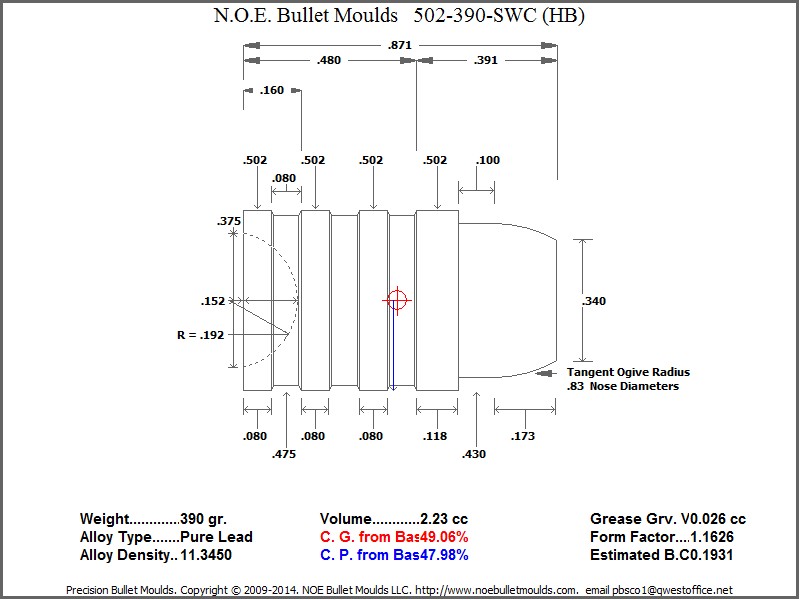

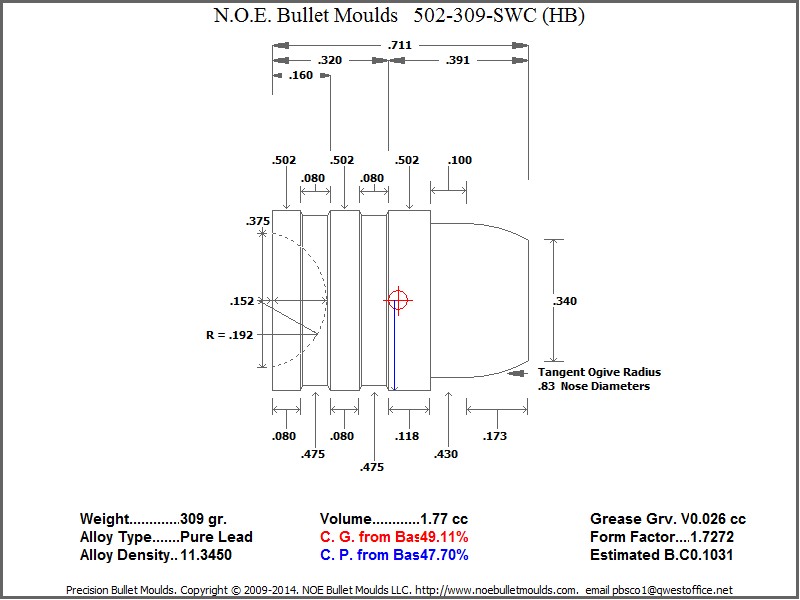

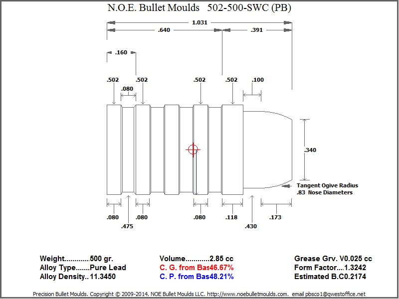

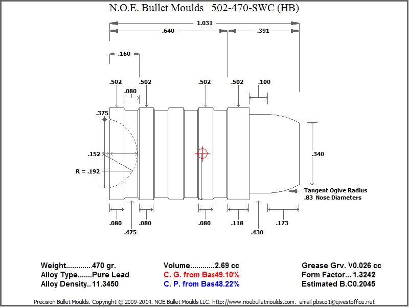

      Up-Date [ preliminary drawings ]
      Will be able to cast the following
      502-500-SWC (PB)
      502-470-SWC (HB)
      502-420-SWC (PB)
      502-390-SWC (HB)
      502-339-SWC (PB)
      502-309-SWC (HB)
      First draft – changes can still be made!

        One issue I do have, and this is my mistake as I misunderstood your intentions with this design, is that I was looking for a plain based bullet weighing around 400 grains.  If I go with a plain based mold I’d be looking at well over 500 grains as cast, right?
        That is not the plan as discussed with Al
        Each weight in FP will have 2 base pins.  One ea HB pin at around 400, 450 or 500g and one ea FB pin a bit over 400, 450 and 500g.  That is 6 base pins per cylinder giving 6 bullet possibilities per cylinder mix or match.
        I think a HP would be stuck at the heaviest weight as far as I can guess.  Al may be able to do some fancy HP pins for lighter weights, but I haven’t visualized it so far and I do not think he has done that rendition of an RG design.  We did not discuss an HP. design at all.

                    Note the change in the Topic line to reflect the 400g 450g 500g multi-weight mould and addition of 500 S&W application
                    Ask Al about the possibility of the 2 different ram rod heads I put on the original drawings.  He’sa thinkin’ on it. No eye deer if it will grow wings.
                    #504388
                    k7sparky
                      Al has added preliminary drawings to the end of the first post on this thread. ;D
                      Is 500 S&W the primary interest in RG HP version?
                      The Keith masters have a taper on the back of the front groove for crimping.
                      I see no BP down side to modifying the front groove to have the Keith crimp groove style and an up tic for the 500S&W and maybe BPCR. 8)
                      Comments?

                        The 420 grain plain based version looks to be exactly what I was hoping for.
                        Count me in.  ;D

                          i looked at the first new image at 500 grains. I like the idea but also believe as you stated a crimp groove of some type would be necessary for the 500 magnum in a revolver. I’m still interested as I’m sure that modification can be made. I am however looking for the hollow point version only.
                          I see the hollow base, but that’s not what I can use. If I had a rifle for it, maybe so, but my girl has been really fare with all my mold purchases, but I need to be careful there,lol. Mama needs to be happy, if you know what I mean. I have not broke it to her about the “1000 dollar club”. Lol
                          I’m hoping there is enough interest for each type, but for me the 500 grain solid is close to a mold I already have.
                          If there was a possibility of having some be hollow base for the black powder folks and maybe another type for us wheel gunners and handi rifle shooters. I’d love a brass hollow point mold somewhere in the range of 450 to 500 grains, plain base. If there was an option for a few different hollow point pins for different weights, that would just be even better. Or say an rg4 version with two, 500 grain hollow points, and two, 450 grain hollow points, brass and in a plain base version with an added crimp groove.

                            My Crystal ball says the final drawings will have a Keith style top groove for crimping :)
                            As I understand the mould making processs:
                            One tool is all that is necessary for both standard mould (no RG), RG base or RG point
                            The RG HB version will have 6 pins per cylinder.
                            In this form the nose is up and cut by spruce plate
                            1PB & 1HB for each length
                            The shortest pin will be the heavy weights HB or PB.
                            The next pins will have a ridge that fits into and seals one lube groove up from the bottom and produce BP or HB depending on the pin.
                            Longest pins will seal the same way in the second groove up from the base and make the lightest PB or HB
                            Mix or match cylinders
                            Machine the block the other way up.
                            The RG HP version will have 2 pins per cylinder.
                            In this form the base is up and cut by spruce plate
                            This RG versions will have FP or HP for each length.  Most likely 3 different moulds to achieve 3 different weights by backing the tool out.
                            This is same way the Keith moulds were made HP or HB.
                            This rendition of the RG Base down tip at spruce plate is 3 different length base pins for 3 different weight Keithesque FP.
                            The HP RG form is the NOE standard RG HP form.
                            The RG HB version will take a bit more care in closing blocks with the medium or long pins so as not to damage the lube groove the pin seal into.  That is why I am probably getting brass as Al is a lot softer / more easily damaged in closing with longer pins.
                            I should have spent longer watching the CNC machine making the blocks and maybe I could have explained it better.
                            Swede will probably need to correct my ramblings a bit :-[
