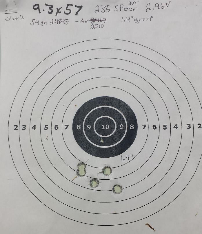

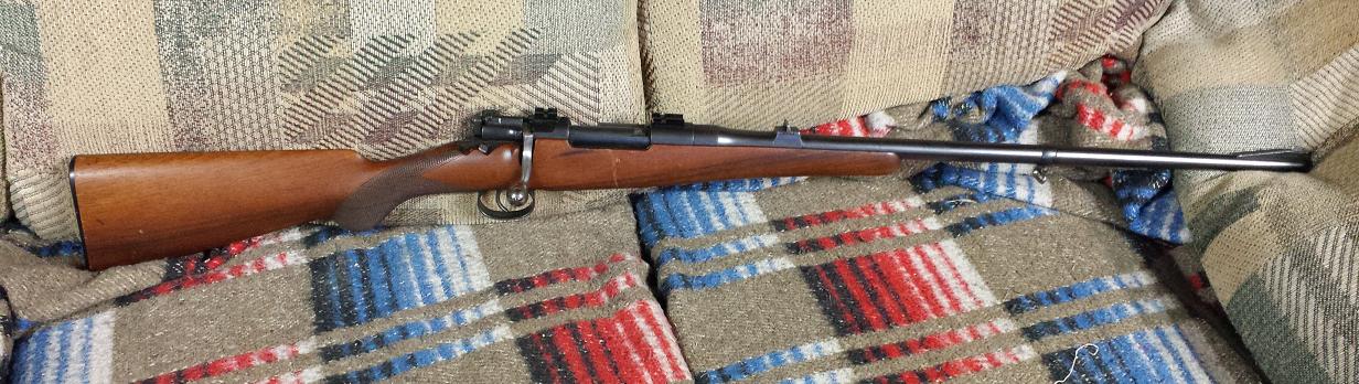

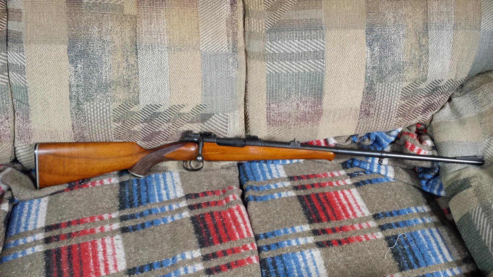

                          Doc44 and I picked up a couple of Husqvarna rifles in 9.3×57.  Doc’s is a M46 and mine is a M46A, both built on Swedish M96 actions and they weigh in around 7#.
                          Here is a pic of mine.
                          and Doc’s
                          Both of them have huge chambers.  They are over size in diameter and length, plus they have over 1/2″ of freebore.  The groove on Doc’s is .371″ and mine is .368″!  The twist is 14″
                          Most of my load development so far has been with jacketed bullets and surprisingly enough, they shoot fairly well.
                          The first loads tried had the primers back out a long way, so…
                          With the chambers being so huge, I necked the brass up with a 416 Taylor expander button, then I backed the 9.3×57 sizer die out abit and sized the brass down, untill the empty cases would just chamber.  I locked the sizer die down, ran all of the cases through it, then annealed all of the cases.
                          For load development I turned to Quickload.  I measured the water capacity of a fired case and came up with 66.5gns H2O vs 63gns for an unfired case.  With the bore area being larger, I put in .103004″ vs .102796″ and made my own cartridge profile.  Most of the 9.3×57 load data out there is kept very low.  The Swedish M96 action was chambered for 6.5×55 which has a max pressure of 55kpsi, so I thought that it seemed reasonable to run the 9.3×57 to the same pressure.

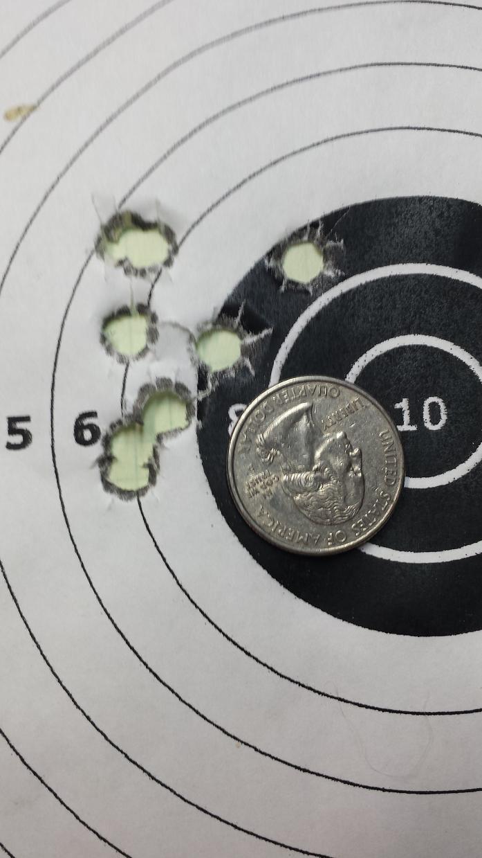

                          I tried the Speer 9.3-270’s first and they shot real well at around 2000fps.
                          We tried sizing down some .375″ bullets with Impereal sizing wax and NOE’s sizers.  I polished the sizer inserts real well with 400 wet and dry sandpaper on a dowel.  With a generous amount of lube, the .375″ bullet will push right through the .368″ sizer die and pop out at .369″ on the other size.
                          Next we located some Speer .375″ 235s and sized them through the same NOE sizer dies.

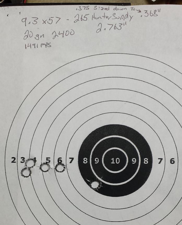

                          Now I’m getting around to trying some cast in the rifles.
                          I have a box of Hunter’s Supply .375 260LFN style gas check bullets, but they don’t put the gas check on them.  I tried some .375″ gas checks and they had problems going through the sizer die, so I tried some 9.3 GatorChecks.  They were a snug fit on the shank of the bullets, but they went through the sizer just fine.
                          I tried 2400 first and played with the seating deapth abit to get this target.
                          With the .565″ of freebore I won’t be able to seat into the lands, so I’m just going to have to seat to the bottom of the neck and hope that the alignment is good enough.
                          The 2400 target looks interesting, so now I’m going to try H4895 next and see if I can turn up the velocity abit.
                          If it looks like I’ll be able to get some reasonable accuracy with cast, then I’ll see about ordering a mold.  The 368-280FN sure looks like a great boolit.
                          If anybody has the mold and could spare a few bullets, I’d be more than happy to cover postage. my email is idahobronco@aol.com
