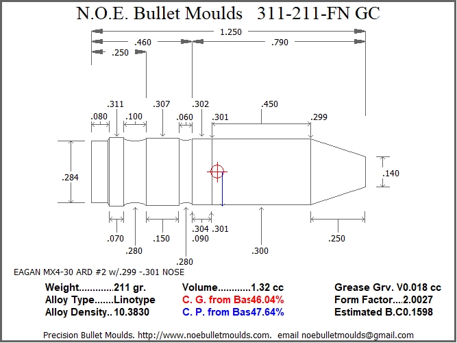

      Any interest.
      Had numerous request for it.
      Driving bands would be tapered per the original
      As well as the nose.
      Any and all input is welcome!

        Will this thing stabalize at 900-100 FPS in a 1:10 ?
        I kinda want a 200-220 grain cast bullet for use in my 308 at subsonic .
        The answer is, yes. The graft is how it should preform in a 10 twist. A stability factor of 1.5 is stable and shouldn’t tip.
        That said, it isn’t a very good shape for subsonic. The large meplate and trucated nose, give low BC’s, because the air has trouble following that shape. A rounded nose with a radi ogive, is much better for subsonic BC’s.

            Have them ran and in stock
            http://noebulletmolds.com/NV/index.php?cPath=30_551&osCsid=8ltvh0tuu85infe99p2sf3uo80
            Thanks to all that have shown interest.
            I’m hoping I can get back on the range to try it out.
