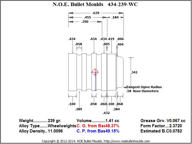

                Can use the tool we have to make one that will be about 240Gr. with a 223Gr. HP
                It would be like this one but the top lube groove would be a Crimp Groove
                #499911
                  :) That looks like what I had in mind…count me in!

                    tomelgan
                      Substantially different than  the Lyman 429-352 . Not the one I had in mind – But if folks want this one then do it.  Let me know if I need to start another interest thread for a Lyman 429-352 as per original thread title.
