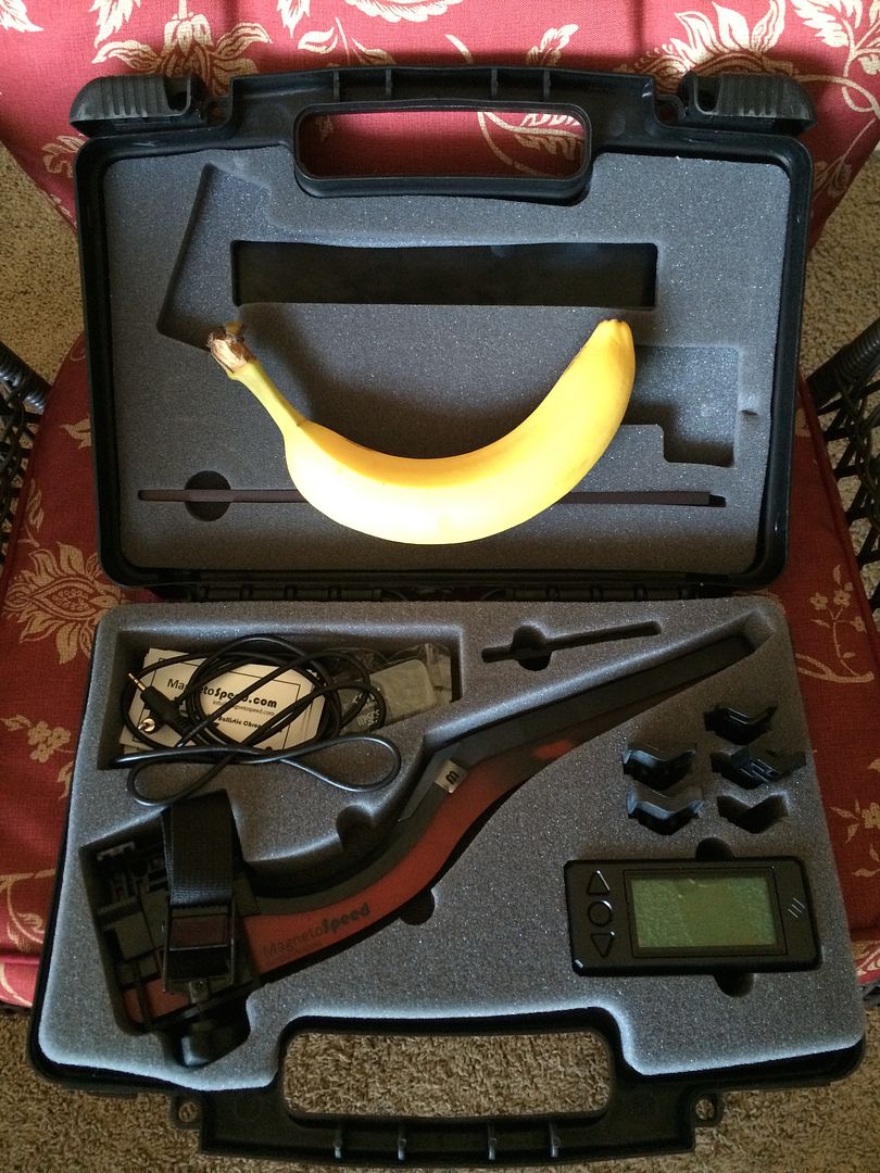

      Just to cover the MagnetoSpeed chronograph very simply: It works perfect with cast bullets, is very simple to install and use, and appears to be very accurate when I compare today’s loads with those previously shot and chronographed. After shooting I took the little SD card out of the display unit, hooked it up to the computer, clicked on the log file and Voila! it opened up the entire range session in Excel. Now I can tape the data on the targets along with the groups for more clarity.

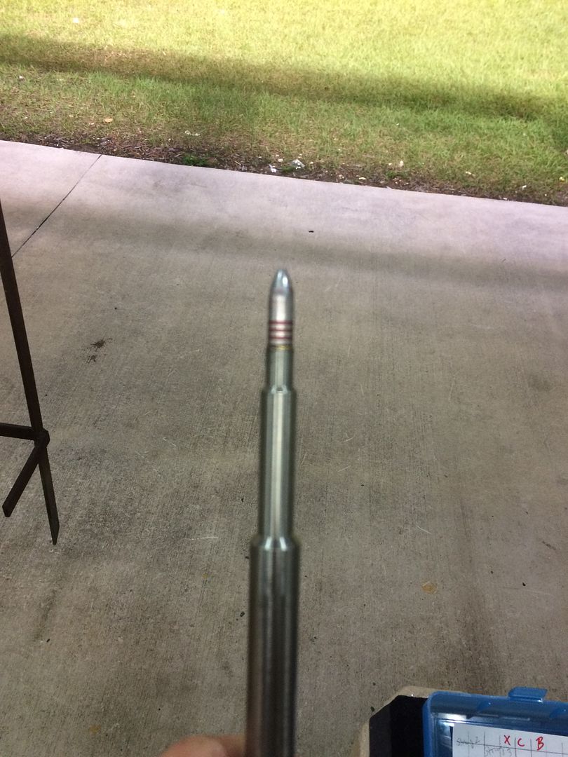

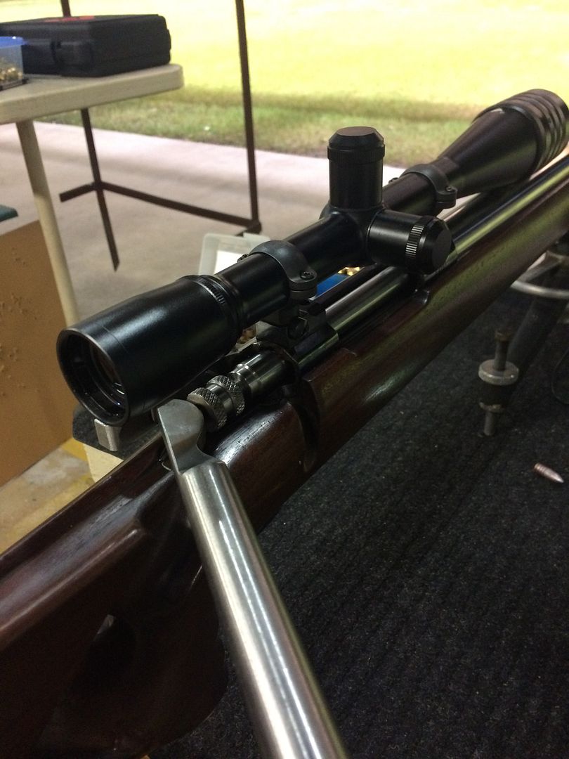

      The Breech Seater was a very interesting contraption, and from my limited use of it today I am starting to believe that breech seating helps accuracy at high velocity.

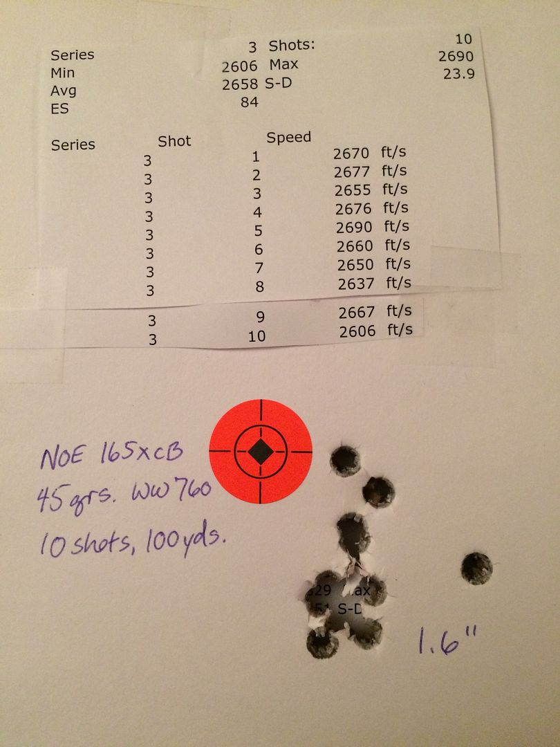

      First off I shot 2 strings with fixed ammo to confirm the velocities I posted in my previous post. I estimated that a load of 45 grs. W760 would give about 2550 fps, and tonight’s shooting showed the following chrono results:
      Both ES and SD were within reasonable limits.

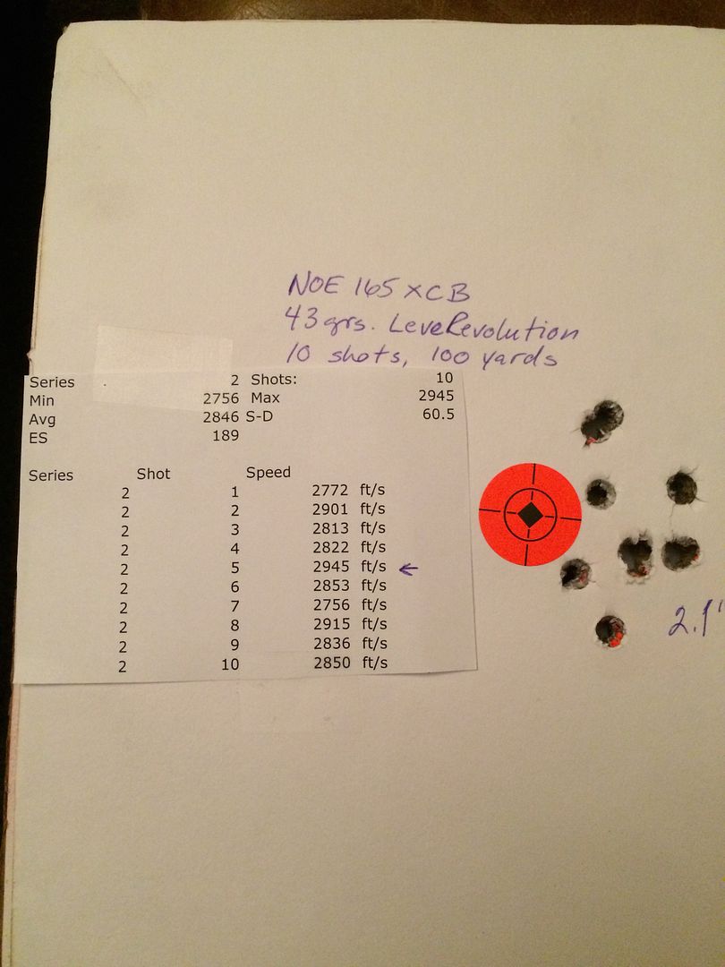

      Then I shot a string with LeveRevolution. That’s when things started to heat up, velocity wise:
      Very good velocities, spreads were a little more uneven. I’ll be trying to push this powder even higher to see if it’ll break 3000 fps with accuracy.

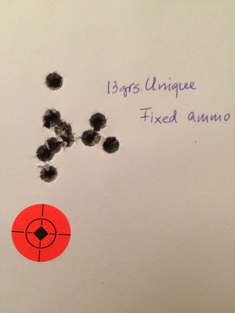

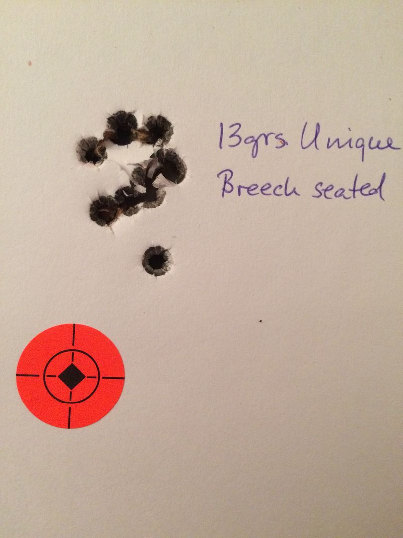

      Breech seated reduced loads didn’t seem to have a large advantage over fixed ammo loads. I shot 2 strings with 13 grs. Unique, accuracy was about the same:

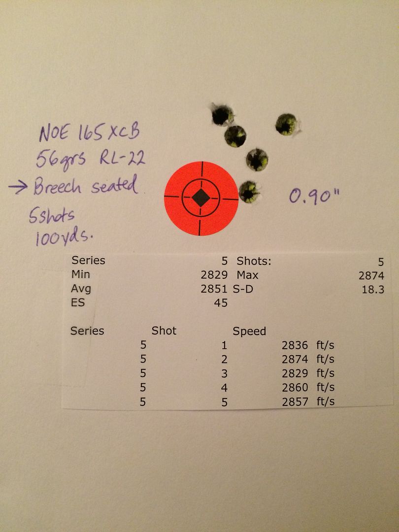

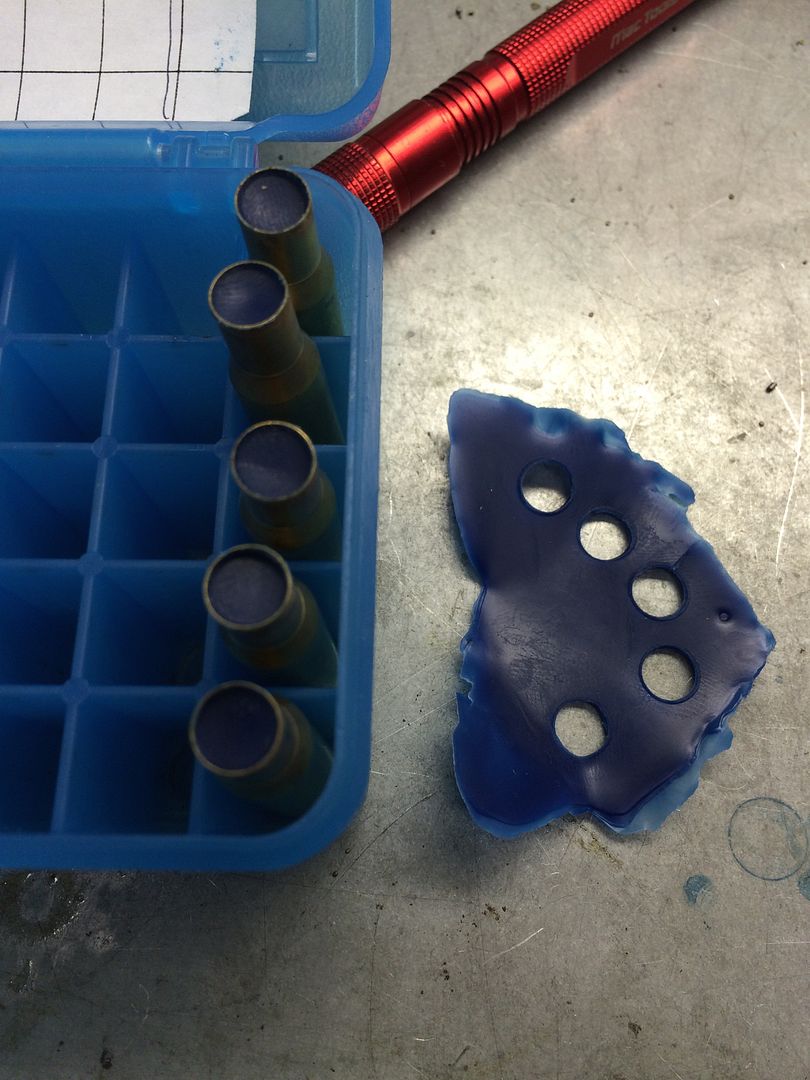

      The most interesting experiment of the evening came when I attempted to shoot 5 cases pre-loaded with 56 grains RL22. This charge fills the case to overflow, so I have to put a “lube cookie” in the case mouth to be able to load the case:
      Breech seating the bullet:
      And the result was pretty decent:

          I have been following along and you are doing some very interesting stuff. But I wonder about the lube cookie what ever the stuff is would that not introduce more lube if not too much lube into the barrel and have a great effect on the accuracy? Would not something like floral foam be better? Just asking?

            On the Mango chronograph, That is just slick glad to hear that it works with cast although I wondered why it would not.

              Floral foam would probably have been a more neutral medium for this task, but I didn’t have any on hand. I’ll try that at some other time.

                LOL yes my new nick name for the MagnetoSpeed chronograph is Mango LOL  ::)
                Why? why not?  Bjornb hailing from the Sunshine state and Mango do grow there LMAO it’s just low hanging fruit to pick.

                      Do you have any adjustment for changing the seating depth of the bullet with your new tool?

                      timmalcolm
                        Glad it worked out for you Bjorn.
                        The breach seater was a concept based on what we know about shooting HV cast. Everybody agrees that the lions share of the imballance to the projectile happens at engrave. Otherwise paper patched bullets could not be driven to 3000FPS.
                        My thought was to control the engraving of the projectile with the breach seater so that it’s perfect every time, and why not? Considering the time and expense people go to to achieve HV with cast, (often recommending casting as many as 2000 bullets (which is committing to $450 of expense if you do any math) simply turning a little bit of metal on the lathe is a simple thing.
                        Now basing success on one range session is not wise, and I can’t wait to see what future outings yield, but 5 shots in a .900 group at more than 2800FPS cannot be ignored. Very very impressive Bjorn.
                        rhbrink:
                        The seating depth is fully adjustable. You simply set the depth so that the plunger anvil touches the throat, then back off .010 for safety.
