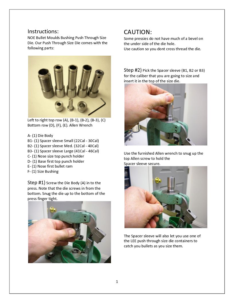

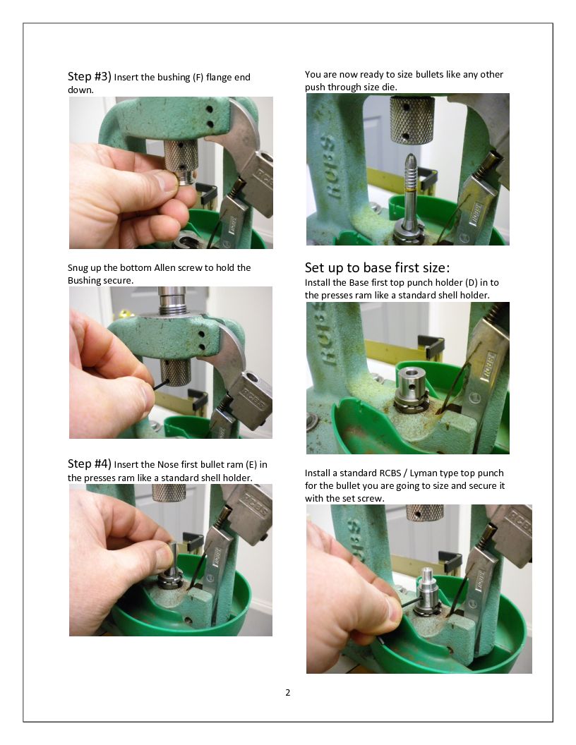

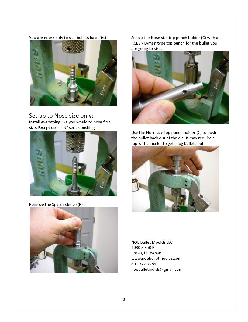

Instructions For Bushing Push-Through Size Die Home › Forums › NOE Forums › Using Our Moulds › Instructional “How To’s” For Casting & Reloading › Instructions For Bushing Push-Through Size Die Search for: Tagged: bushing, die, push through, sizing This topic has 1 reply, 1 voice, and was last updated by Full.Lead.Taco. Creator Topic 2022-12-01 at 14:18 #513609 Full.Lead.TacoKeymaster Up0Down:: Creator Topic Viewing 1 replies (of 1 total) Author Replies 2022-12-01 at 14:20 #513610 Full.Lead.TacoKeymaster Up1Down:: Here is a video showing it in use: Author Replies Viewing 1 replies (of 1 total) You must be logged in to reply to this topic. Log In Username: Password: Keep me signed in Please enter an answer in digits:12 + fourteen = Log In
