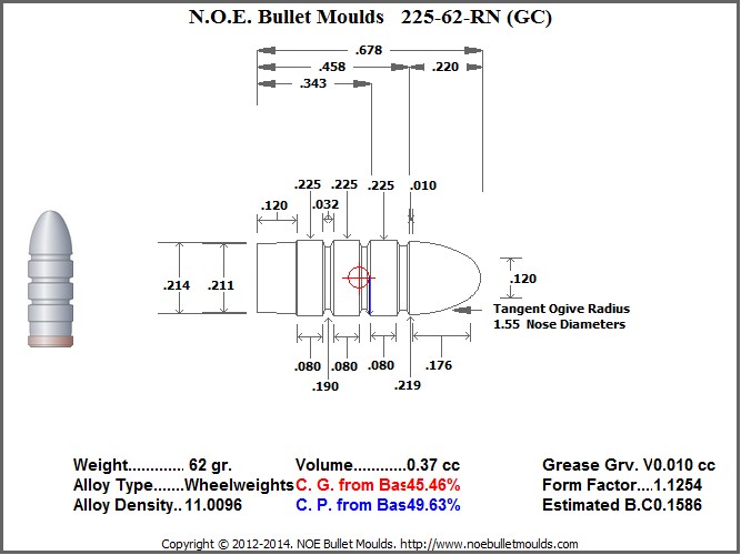

      I have this slow and heavy lyman and would love to have a larger one made by NOE. It’s a great shooter and came highly recommended. It’s an old one no longer in production and I’m hoping to pull together a GB on it. Is there anyone else that would like to have this In a NOE mold.

          I would be interested if the design followed the lyman exactly.Also if it was put in blocks that could be made as a RG-4 mold.

              Sorry, I corrected it, it’s 462.
              #498203
              johnblackwell
                I wouldn’t change a thing except more cavities and al.
                As far as the rg, I think HP is the only option in the 22 size.
                #498204
                terrysangl1
                  I seem to remember seeing .20 being the min meplat for the RG option and most 22 mold cavities are too close together for all the hardware on the bottom. I wonder if Al would entertain some Cramer style HP molds sometime?

                      1johnlb
                      Can I get some samples from you?
                      If so send them to:
                      NOE Bullet Moulds LLC
                      1030 S 350 E
                      Provo, UT 84606
                      #498207
                      johnblackwell
                        I’ll cast some today or tomorrow out of straight ww and get them to you.

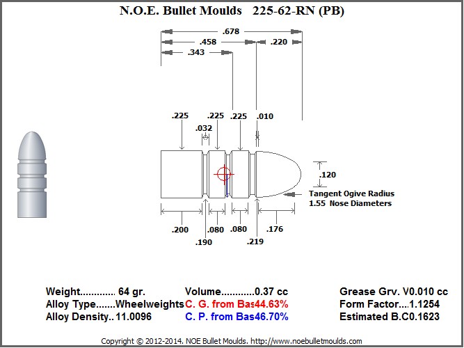

                                Is it PB version possible?
                                #498212
                                  Done
