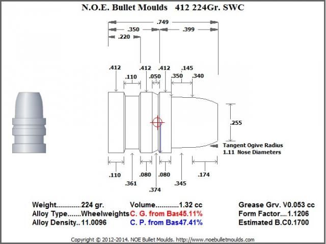

Participant::I have some and will try and get them in the mail to you tomorrow
Actually, your NOE 41 cal 220 SWC is a very close match to the H&G 258 which I think is a better overall bullet
I would very much like a new run of those when you can get to them
Really when you get down to it, either bullet will get the job done2014-06-02 at 02:43 #491251anthonylafleur
Participant::Although I have used the 410459 for many years, I never cared for the narrow front driving band. It has always performed well, but a wider front band in the “classic” Keith style is a more attractive option IMO…I also like the wider meplates in this size revolver (really wide) , as a general rule.
2014-06-02 at 21:34 #4912522014-07-01 at 15:18 #4912532014-07-02 at 16:13 #491254brianadams
Participant2014-07-13 at 05:18 #491255thomasgarcia1
Participant::The 410459 is ok. I’d prefer a more robust meplat and fatter driving bands. I have an H&G copy. Perhaps a slightly heavier weight around 240? On the classic H&G style but slightly longer, a fatter driving band, square grease groove and fatter meplat to get the weight up a little. I’d be in for one like that.
