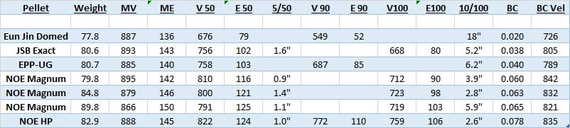

      I did a bit more testing today with my LabRadar…. I reset the distances to 70 and 90 yards instead of 75 and 100, to get more reliable data at the longest range, and I am pleased to report that with .35 cal pellets and slugs, the data is rock solid at 70 yards, and only a couple of shots were dropped at 90, so my confidence level is much increased…. I retested the 83 gr. NOE Hollowpoint, and added the 81 gr. EPP-UG slug, and also the old 78 gr. Eun Jin Domed pellet…. Here is the chart showing how they performed….
      https://hosting.photobucket.com/images/oo221/rsterne/357_Summary2.jpg?width=1920&height=1080&fit=bounds%5B/img%5D
      The Eun Jins were pretty dismal…. Not only did they have a low BC, but they sprayed the 100 yard target with an 18″ pattern at 100 yards…. The EPP-UG slugs were only a bit worse than the JSB Exact pellets of the same weight, and had a similar BC…. I have revised the BC on the NOE 83 gr. HP downwards slightly, based on the better data at long ranges…. However, it is still far better than any of the others….
