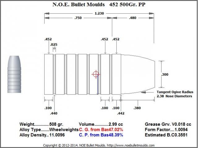

        Getting more and more request for Paper-patch
        Could run something like this in a single cavity block with our Lyman type pin holder
        Can play with the meplate and nose shape some if we need too
        #493235
        anthonylafleur
          Outstanding!
          A single cavity tall block that could work in multiple weights and fit in multiple throat configurations… I’d have to move this to the top of the “Want List”.
          Thanks for the drawings, Al.
