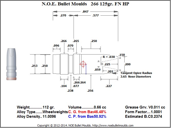

          davidlawrence
            Al,
            Any chance we could see a 6.5mm hollow point boolit design similar to the NOE 246 104Gr.

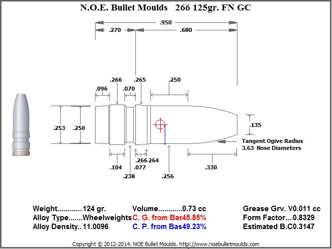

              We have a limitation on the RG moulds of .20 on the meplate.
              Not sure how that will work out with this design.
              Will try to get a drawing together in the next day or two

                            Too bigger meplat may not work in the AR’s so we may be better just leaving it as original.
                    Juddy

                      #494455
                      Greg Parsons
                        Yes the non hollow point is the one I want.

                        andrewjudd
                          G’Day Al
                                        I reckon the solid with the .135 meplat is the one. The people originally signed up for that design with A.C.E. and were happy. To let everyone know, I’ll be using mine in a bolt so meplat size doesn’t matter to me and also I love RG’s. But we need to make sure the design is one that the good folks at NOE can continue to sell and this design suited to the AR (we can’t own then in AUS) will be a better choice economically for them.

                          davidlawrence
                            If the consensus is no hollow point I’m ok with that.

                            Greg Parsons
                              I like the original design the best with the small metplat. I will be shooting it out of 3 different guns but only one is an AR, the others are a pistol and a bolt action. The bolt action is why I was wondering about the 145 too. If anyone has an answer to that question I would love to hear it.

                              robertkras
                                I’d love both the HP and flat but could live with non-HP.
                                I would go for a a 4-banger.
                                Wasn’t the original 120 gn though? I just want to make sure whatever it works out to it can feed in an AR.
