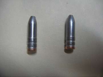

          After putting a little more of a radius on the entrance to the nose sizing die and using STP , my case lube, to lube the nose, the sizing was pretty much effortless and smooth. So much so that I could then feel the front of the first driving band “bump” up against the bottom of the nose die. Slight but I can still feel it.
          I have a Hornady single stage press and at one time I had drilled and tapped a hole through the casting that the links and handle attach to. Then used a 1/4×20 bolt that bumps against one of the links of the press on the down stroke. This arrangement creates a positive adjustable stop for the press handle Eliminated the problem.
          As it worked out, I think that using a good lube such as STP or maybe even Motor Honey is the key. I tried to post some photos but this forum won’t let me because it says that they are too big.
          The noses on these 7mm bullets were sized down .003″ in one stroke ea. through a .275″ bushing.

            Attach the pictures to a e-mail and I will get them posted
            pbsco1@qwestoffice.net
            Got to have pic’s!
