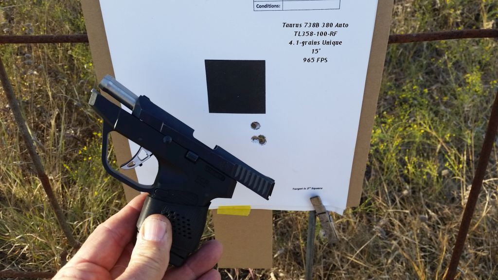

                I’ve been doing some load work over the last two days with my TCP 738B and the  358-100, switching my powder choice temporarily, from Universal to Unique as I want to use up an old cannister of Hercules. There is a fellow that is also going to do some shooting with it from the new Taurus Curve.
                Here are a couple of loading suggestions from a guy that uses Lee equipment. Use the NOE 38SPEXP, Powder Through Expander, to expand the case while you drop the powder. You will eliminate runout issues as well as case wear expanding rather than flaring with the Lee plug. We desperately need to have Al make a 32 Auto Powder through Expander plug part of this buy! Currently, the only plug NOE has is the 32AP, which I use in a side operation but it sure would work better including this with the powder drop. While adding the links for the plugs, I noticed that the 38SPEXP but it really needs to be available for this buy. I feel that strongly about the value it adds.

                  Al and I use the same design and the draft might be there and just not presented in the drawing, it is controlled by a check box. The only other thing that I see is the BC. The software designer, Tom Myers, suggests using 50% of the meplat as the BC for the bullet and my actual two velocity testing has convinced me that Tom’s calculation is correct. I show the BC for the 314-75 as .108 and the 358-100 as .109. Kind of making the silk purse out of hogs ear over the BC for a bullet that is probably going to be shot at 21′. Speaking of hogs, I might be the only guy that has killed them with 32 & 380 Auto. I was trapping them, sorting them so that I could cull them by size at 21′. All my bullets except the 25 Auto have been tested on feral hogs in the 150# range and all have simply shocked me how quick the critter is dispatched with a broadside, chest cavity hit. The terminal response from both the 32 & 380 Auto was immediate.
