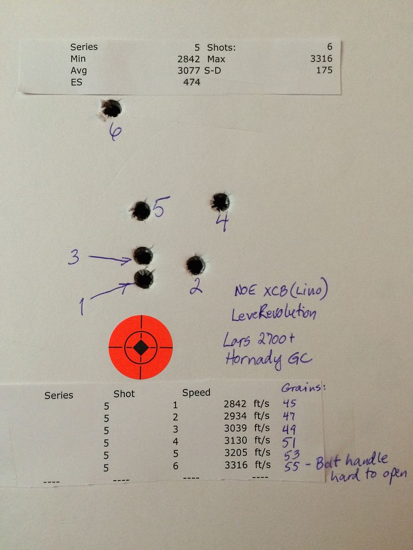

      I finally found time to shoot my 30 XCB rifle today, bringing along several loads that I had prepped after last week’s outing. Today I was going to shoot ball powders, both Hodgdon LeveRevolution (LvR) and Winchester 760 have given higher velocities compared to extruded powders in earlier trials. All HV shooting today was done using Tim Malcolm’s breech seater, as max powder capacity and highest possible MV was the goal. To recap, my 30 XCB rifle is a target rifle from the 1950s, built on an FN Mauser blind single shot action. The barrel is a new Shilen Match, 31 inches long, 1 in 14 twist. Tim Malcolm (Goodsteel) recently re-barreled and re-bedded the rifle.

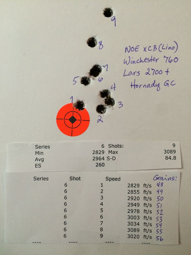

      I had devised a “ladder test” of sorts, to figure out at which MV the bullet/lube/powder charge combo would lose accuracy. Not to be confused with the Creighton Audette ladder test, this was simply a series of charges starting at a known level, increasing by 2 grains per charge for the LvR and 1 grain per charge for the W760. Here are the targets for these 2 “ladders”:

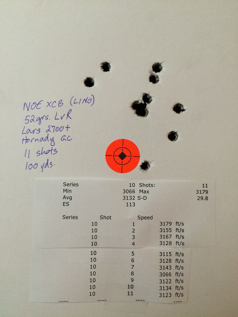

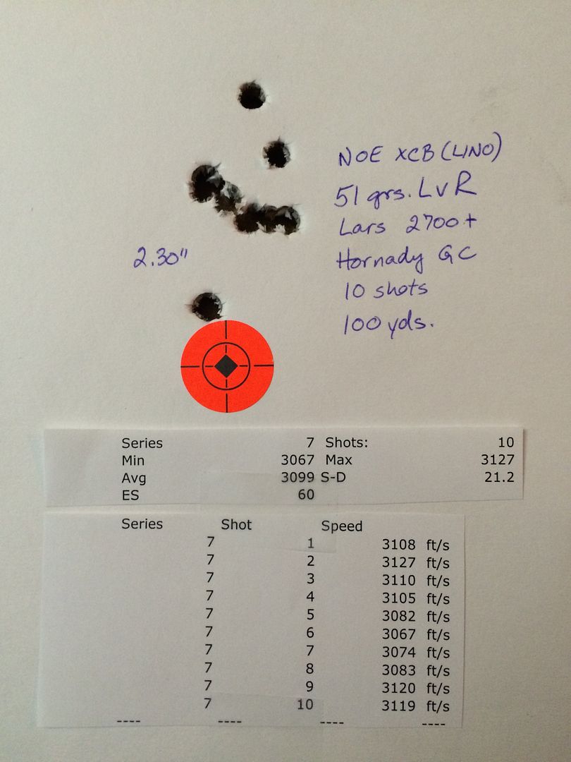

      At this point I picked one charge from each “ladder” and shot a 10-shot group of each. I picked charges that I believed would stay together:
      Finally I upped the charge of the LvR powder by one grain and shot another group. This turned out to be where accuracy went south:

      I have to say that this outing was very encouraging, and it certainly proved to me that the NOE 310-165 FN (XCB) is an outstanding bullet, and that White Label 2700+ Carnauba Red is an outstanding lube.

              Excellent test.  Obviously that which several of us have been predicting for several years is coming to fact.  Given the 14″ twist I would suggest the 1st LvR load of 51 gr at 3099 fps was probably a tudge over the RPM Threshold as evidenced by the probable 2 flyers of that group and how accuracy really went south with one more grain of LvR.  Be interesting to see what happens with 50 gr LvR at 3000 fps +/-.  Particularly when noting the 1.43″ group at 2987 fps with the 760 powder.  The LvR powder will have the slower time/pressure curve and should do well at 3000 fps.  Additionally it will be interesting to see how seated bullets in the 30×60 will compare to the BS’d bullets in the 30 XCB given the case capacity will be close to the same given the different bullet seating and how much difference the 16″ twist will make vs the 14″ twist.
              Again we have reached the goal of 2 moa or less at 2900+ fps as we predicted we would.  Now we can concentrate on tweaking the loads and bullet alloy seeking best accuracy.

                        Nice work.  Good write up.  Thanks for sharing.  I find the 9th shot in series 6 interesting.  One grain more powder but less velocity than shot 8 and it impacted higher.

                          Funny you should comment on that Tim. While loading the charged cases, up until that point (including shot 8 ) I had been plugging the charged cases with a very small piece of floral foam. At that point the next case (shot 9) was difficult to load, so I fished it back out and shone a flashlight into the chamber. There were small droplets of melted plastic on the chamber walls. Not wanting to clean the barrel in the middle of a shooting string I carefully cleaned the chamber only with an M1-style chamber brush, not entering the bore. That cleaned up the floral foam residue. I then plugged the case for shot 9 with a small disc of lube and fired the shot. It went high, and the MV registered lower. Thereafter the remainder of the strings were fired with lube as a powder stop. That’s the only explanation I have for the POI vs. MV readings, and maybe it taints the string. However I don’t pretend it to be a scientific test, and the difference in the stop plug material could have easily caused the POI variance. Good catch.
