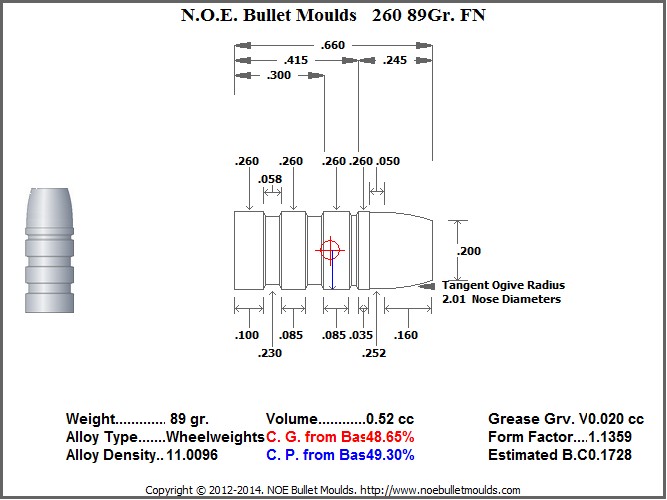

                  #493466
                  tomelgan
                    Al – How much of a reduction did we get in the lube groove width and depth? The ones in your drawing look to be just about the same as those on the RCBS bullet. I believe the depth on the original RCBS is considered by many 25-20 shooters to be a design flaw in that it holds too much lube, contributing to fliers. There is some very good discussion on this over on the Marlin Owners Website on the 25-20 Reloaders thread by 35Rem (who seems to be our local 25-20 expert on the Cast Boolits site). Eric – At Hollow Point Mold Service performs a modification on the RCBS mold – Reducing the lube groove to half of it’s original depth.  Like the wide meplate.
                    #493467
                      I think it could be improved with 3 smaller grooves
                      and keep the weight the same
                      Could lube as many grooves as it needs (1, 2 or 3)

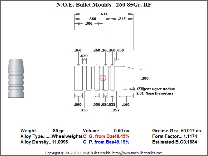

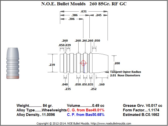

                            johnalbert
                              For reasons having to do with the desirability of thicker bands, and having to do with a distinct identity that is less similar to what has already been produced, I’d like to stick to two narrower (and shallower) lube grooves. Does not matter if weight goes up a little as length will be the same. I am after less lube contact area and a stronger bullet.
                              A thicker base band going toward the 260283 is appealing. This has meplat advantages over that bullet and would be shorter so no duplication there. Should stabilize at fairly slow speeds even in 1-14, and I’m looking for low to high velocity capability. Would also be interested if I could get mixed GC and PB cavities in the same mould block.
                              #493472
                                How’s about this one?
                                Can do 2 cavity 1GC 1PB or 4 cavity 2GC 2PB too.

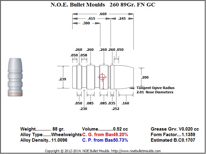

                                  peterogers
                                    I’d be interested in this… (shallower lube groove design)….
                                    4 cavity all gascheck.
                                    The original RCBS did have way too much lube capacity. Probably was designed for black powder.
