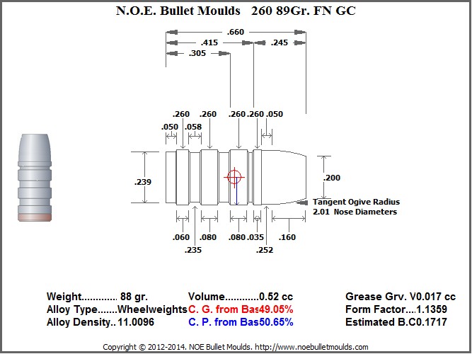

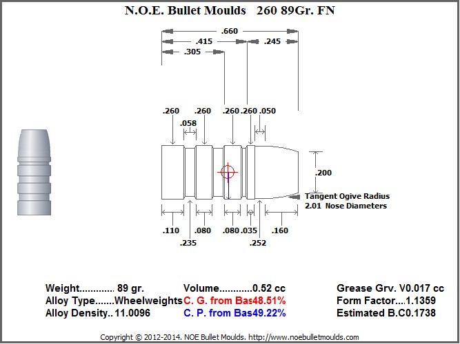

        If I’m reading this correctly, both grease grooves of 0.020 CC each on the revised two groove design equal 0.040 CC lube capacity total.  This about equals what one groove has on the original RCBS design (0.037 CC).  Original RCBS would be 0.074 CC total.
        The three groove iteration would have 0.017 X 3 or 0.051 CC total.
        This lower capacity for lube with the two narrower shallower grooves is closer to what I’m after.  Stronger bullet, substantially less lube.  I would like to maintain bullet integrity most especially for the GC version at the higher pressure levels if the lube grooves are unfilled (some like to tumble lube occasionally like me) by tending any further changes toward shallower lube grooves as the deep grooves are tending to be the weak point of the design.  The bottom lube groove is the most likely to distort under higher pressure permissible with gas check bullets if the lube groove is unfilled.
        How about .235″ for the width of the bullet bottom of groove to bottom of groove and calling it good?

            I agree with 35remington that a .235″ grease groove depth diameter would be even better for correct lube volume.
            Actually if I was designing this bullet I would prefer that the two main body bands  be shortened lengthwise from .085″ to .080″. Then I would add this .010″ to the base band width increasing it from .100″ to .110″ in the plain base version and from .050″ to .060″ in the gascheck version. The base is where we need the base band width for more resistance to gas cutting in plain base and additional strength for high velocity loads in the gascheck version.
            I also think the gascheck shank diameter is undersize and should be checked for the final drawing. I think it needs to be changed from .239″ to .244″.
            This would be an accurate and great hunting bullet.

              2520WHV
              Take a look and see if this is closer to what we need / want
              The gas check shank is kind of a self correction problem, it will be cut to fit when we run them.
              Just need some more interest to get it started and 10 orders to get it done

              peterogers
                Al,
                To me that is a GOOD design! It has good shooter written all over it!
                I am certainly in for this last version in aluminum 4-cavity gascheck!
