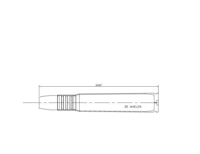

      Would it be possible to get a 360-245± bullet with this profile? I think I would like to try one of this RD style. This one works just so well in my .30 that I’d love to have a .35 caliber of it.  ;D
      Interest? Thoughts? Reasons it wouldn’t work?  8)

                Let’s get a pic up of this 360-245 so we can line up some buyers! Woot!  8)

                  I’d be in for this one.What about an rg version with hollow,cup, and flat point pins as an option?
                  Either way i’d be in for one. Would like to see the drawing though. But as i already shoot the noe 200 gr. and the noe 358009 the length of this one should be a go for my rifle.

                    Looks interesting…Do we have a dimensioned drawing showing distance from base to crimp groove(s)?  This would be for a 358 Winchester and I’d also like to keep a good portion of the check in the neck.
                    Thanks, Brad

                      OK – this is based on the 359 190Gr. RF with the nose ran out to get 245Gr.
                      Not sure how it will interface with the throats yet but something to look at
                      Could enlarge the 311 165Gr. RF too if need be.

                        That’s what my original intent was…… the 311 165RF if it would work.  8)

                          This is what we would get if we just took the tooling
                          for the 311 165Gr. and ran it out to .359
                          Again I haven’t checked for fit or function

                              Something more to look at

                                Now that I see both I’m leaning towards the bullet with the profile of the 311-165. Stretching the nose on the 359-190 makes it resemble the 360318, wasn’t able to get good results with that long nose in my 35 Whelen. Had feeding issues in my Winchester with a bullet of similar dimensions- the 360-235 “Thor”. I think the 359-190 had a short base to accomodate the 35 Rem, I like the way the 359-228 appears to go all the way to the base of the neck of the 35 Whln. The 359-228 should move the ogive out close enough to the rifling in my rifle that I won’t need a second crimping groove.

                                  I like the larger radius of the 359-228. The smaller radius of the 359-190 would likely result in a shorter, lighter bullet and if anything I’d like the 359-228 to be heavier. Between the 359-245 and the 359-228 I’m thinking the 359-228 would be my choice. I like the TL design but I think in a 228gr bullet in the 35 Whelen may be pushing the limits of LLA so I’m thinking conventional grease grooves would be appropriate.

                                    Like the looks and bearing surface of the 359228 the best By looks i mean the more supported nose on it and also the lube grooves. Would be nice to have more weight on it but not sure what that will do to the profile? Anyway i do have a question and that is are these moulds in the end supposed to pour .359 or .360 dia?
