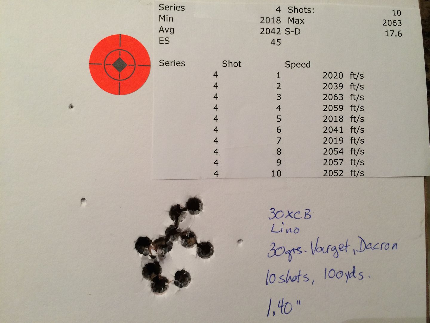

      When I did my “HV lube test” the other day, Geargnasher commented that I hadn’t shot sufficiently large strings for the bore to get conditioned with the lube. I have to admit that he most likely is right, and today I wanted to give this famous lube a fair shake. At the end of the day a hundred rounds lubed with FWFL had gone down the bore, and here are some of the highlights:
      First I shot a few mild loads – 13 grains of Unique. After the first group of 6 I went directly into 3 strings loaded with 28 grains of Varget. The first 2 groups, 15 shots each, were filled with 3/4 gr. Dacron, with the third group (10 shots) I used Puff-Lon as a filler. This is a powdery substance that is compressed (by 20%) between powder and bullet base. I could not detect much difference in accuracy between the two methods.

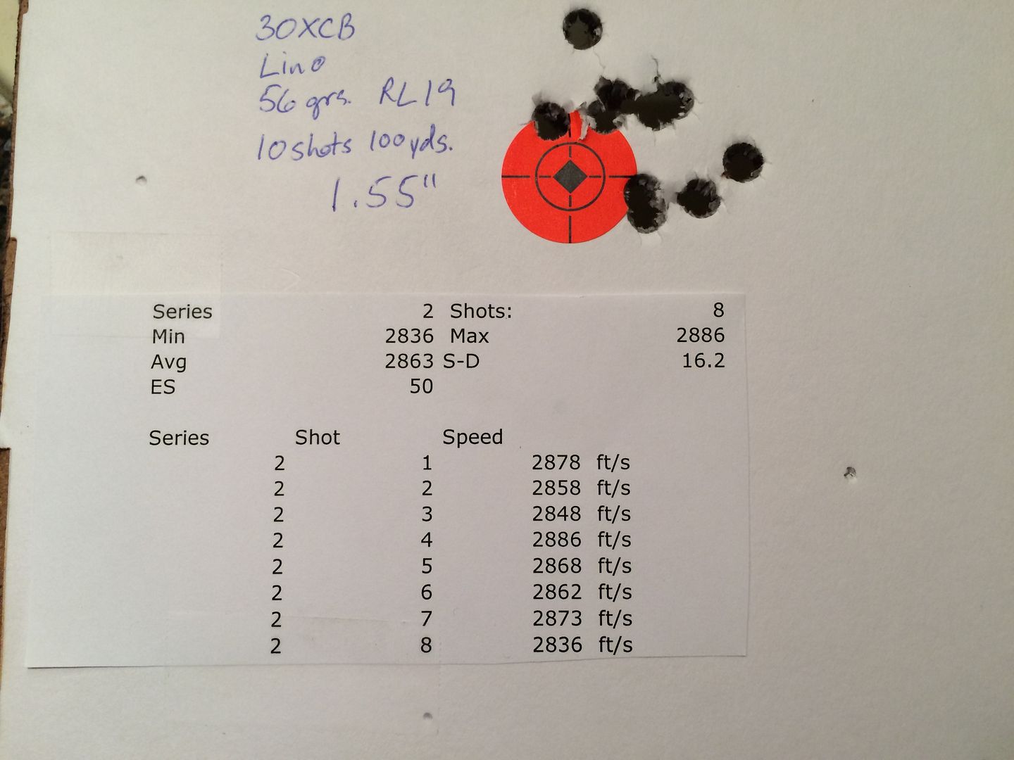

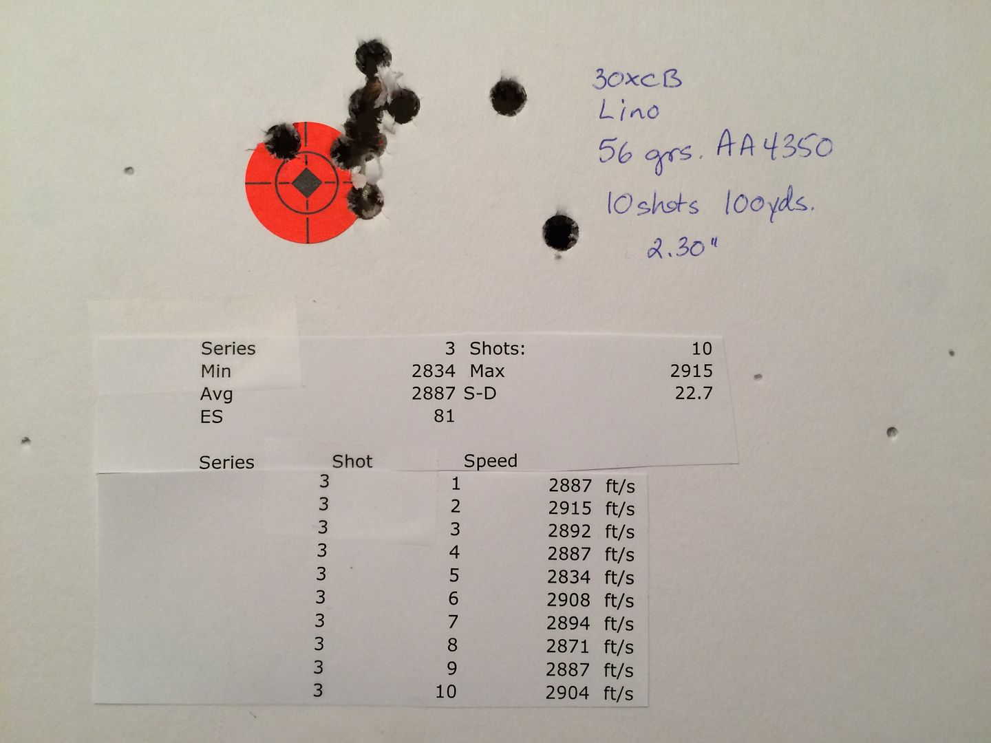

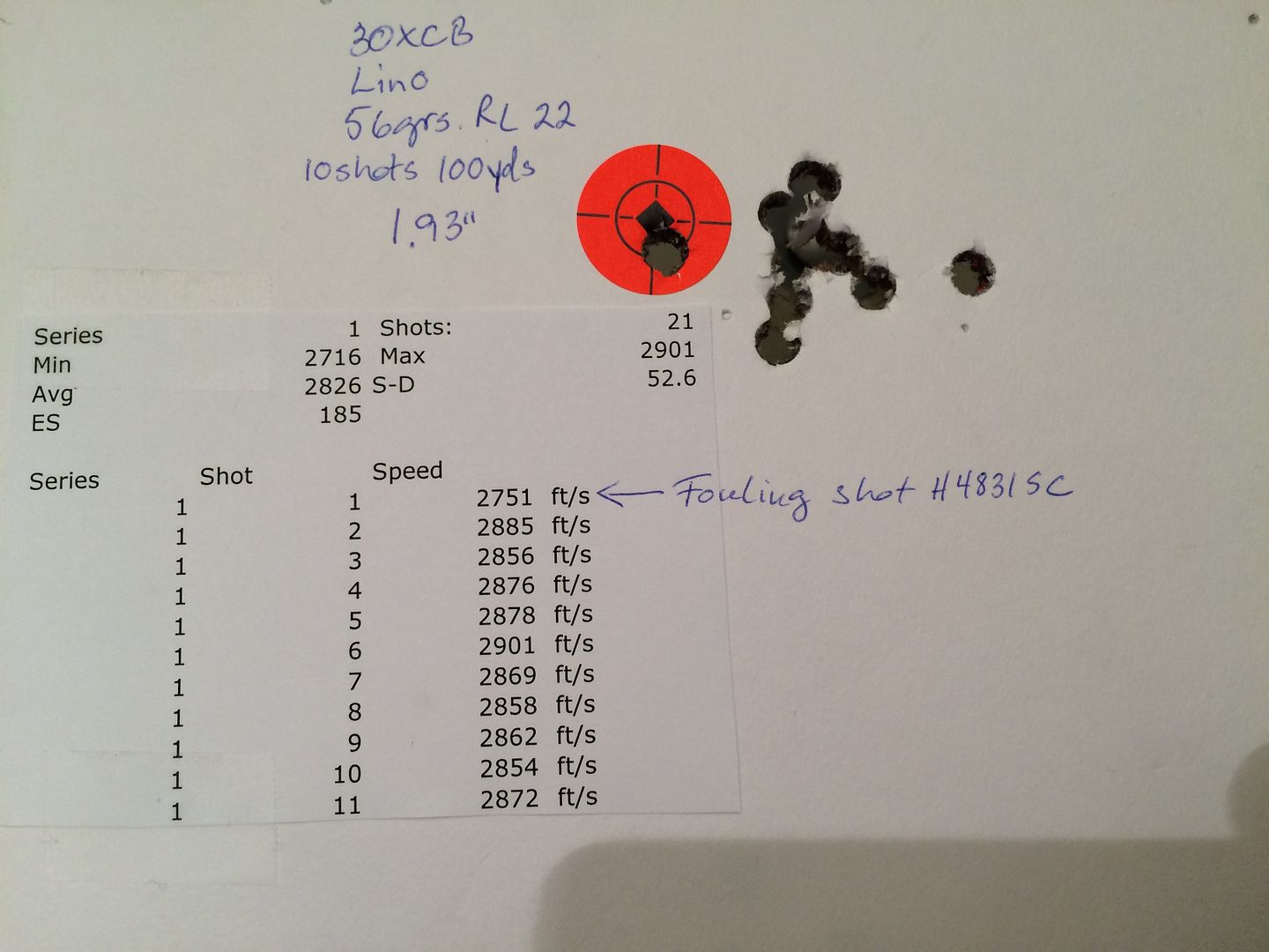

                          bjornborud
                            A quick range report, as usual shooting the NOE 310-165-FN, lubed with White Label 2700+. I continued to load using the breech seater from Goodsteel, trying to see how fast the rifle would shoot with sub 2 MOA accuracy, which was the original parameter set for the XCB project. Today I shot 4 groups for velocity, using the following powders: Reloder 22, Reloder 19 and Accurate 4350. One fouling shot was made with H4831SC (just to get a ballpark velocity number). Then I shot one group with Varget, trying to see what kind of accuracy the rifle would deliver with a “standard” CBA match load. All charges and velocities are printed/written on the target photos.

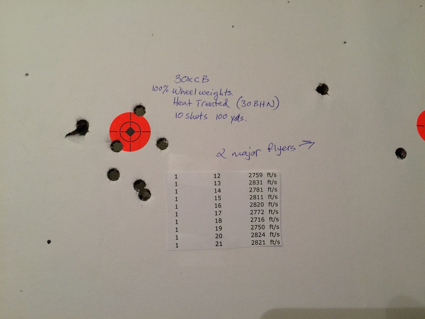

                            In the second group, using 56 grains RL22, I used bullets cast from straight wheel weights, heat treated to 460 degrees for one hour, then quenched in antifreeze measured to -1 degrees F. Aged 4 weeks, they measured 30 BHN on an LBT tester. They did not shoot well. I can not explain the fliers. The chronograph sheet for this group looks funky because I forgot to start a new string, so they were part of the first shooting string.
                            Here’s an interesting tidbit: In the 3 decent HV groups, shot with 3 different powder but with the exact same charge weight, the MVs are pretty much exactly the same regardless of burn rate. The primers showed no pressure signs, and the rifle never showed any other signs of pressure (bolt hard to open, excessive recoil etc.). Does it have any significance? I don’t know, but I’ll be happy to hear what you guys think.
                            The group shot for accuracy (with Varget) is not much to write home about. I’m thinking the breech seater is shining in the higher pressures and velocities, and not so much when shooting slower loads. I’m able to shoot pretty much the same groups or better with fixed ammo.

                              Another excellent report.  Have to say holding that accuracy at 2800+ fps with cast bullets is excellent.  Your powder capacity BSing the bullets with the 30 XCB (30×57) will be just about the same as with the 30×60 with the bullets case seated normally.  It will be interesting to see how the velocities compare with equal loads.
