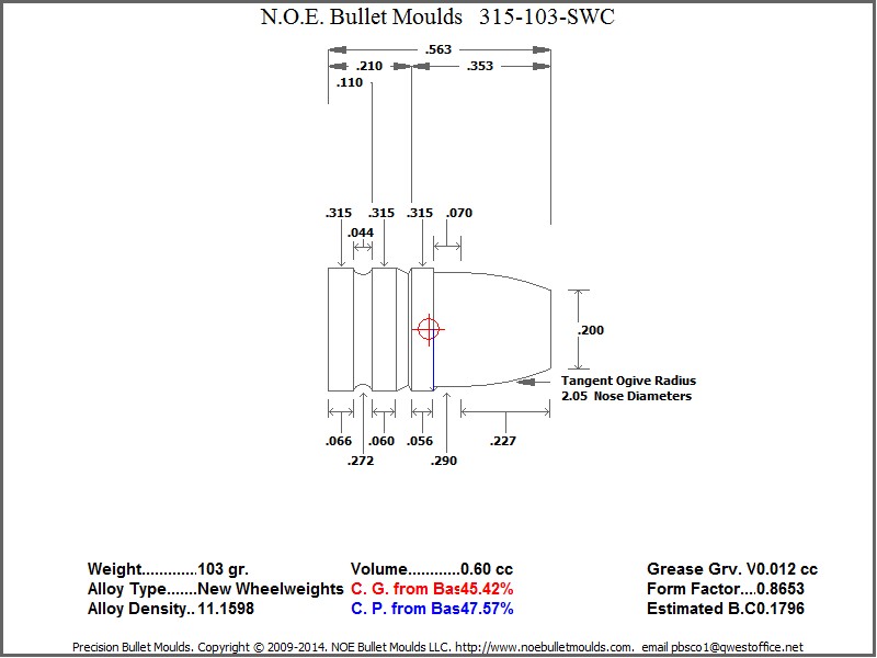

                If this will drop at say .315, it looks like it would be great for 7.5 Swiss revolver, and would hold enough lube for use with 11gn of Holy Black.

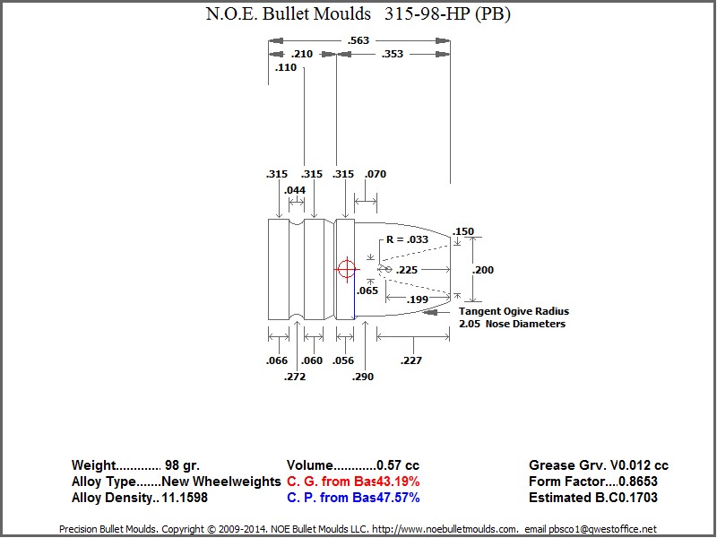

                    #500062
                      Can make any changes required
                      #500063
                        Perfect  ;D I want RG2…Or should I take 2-cavity normal brass and 2-cavity alu. RG…
                        #500064
                        danielmauck
                          That’s really pretty, I’d be in for an rg2.  I notice that this one 8s spec’ed for “new wheelweights”  did they change again recently or does Al mean the same ones I’ve been using this whole time?
                          #500065
                          Anonymous
                            Now with the drawing my hope is the .30 caliber rifle shooters will consider this a viable plinking bullet. This forwards the hand gunners chances. I didn’t think of the air gunner angle until teemu brought it up. Lots of possibilities. I’m still in for a pair of moulds, a 5 cavity and a rg4.
