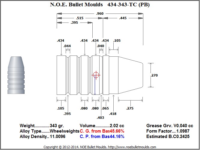

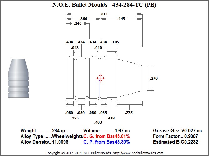

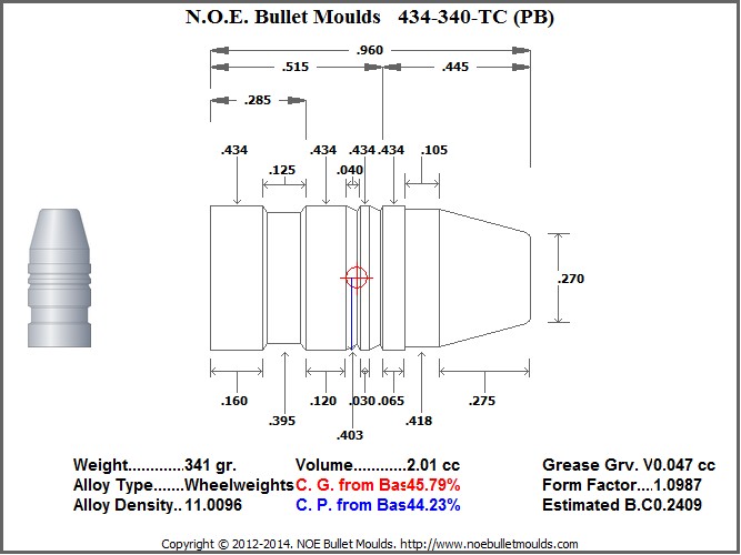

                          This is the double crimp groove
                          And what we would offer for the NEI heavy
                          And the light
                          What do you say?
                          #495268
                            The drawings look great but even the lightest one is heavier than I need. Will there be a HP available? That would bring the weight down about 15 grains and be right in my desired weight range.

                                That 341 grain looks really good for my rifle, but I also wanted a mould that would work well in my TC at around 310 grains, double crimp groove and in the neighborhood of .431.  I size all my 44’s to .430 and those would be taking a little more off than I would like.  But that’s just me, so I hope they work for everyone else.

                                  While the diameter is exactly what I was wanting, The boolit weights are either lighter or heavier than what I was hoping for. I was also hopeful for a gas check version of the 310 gr . I will have to pass on this mould unfortunately.

                                    I for one like what I see. I think that 340 gr. would make a moose awful sick. I hope these all 3 go I will take one of each. I don’t need a HP version of these. Let’s make this happen!!!  jroc
