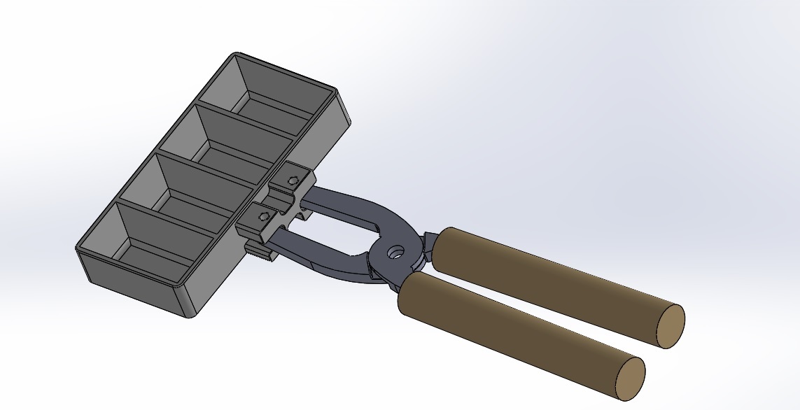

                    What about making them so you could use a set of LEE mold handles? We all have a set or two of them laying around
                    #493817
                      tomme boy
                      Great minds think alike
                      Matt came up with the same idea.
                      You can fit a regular pair of pliers in the center or attach our handles to it.  It will give you exactly 1 pound ingots with wheel weights…
                      What do you think?
                      #493818
                        That looks as though it would work.
                        Will the mould sides be tapered?

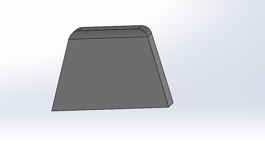

                          dromia
                          This is a section through the ingot
                          What kind of “other hand stamp options” would we like to have?

                            tomme boy
                            What do you think?
                            Wow!!! I just bought my first NOE mould handles since I am now the proud owner of 2 NOE moulds. I really like this design.
                            Can we have “NOE” ingraved inside the mould

                              dromia
                              Looks just tickety boo for me I’m in for a few.
                              I’m happy with only the NOE logo, as I just use a permanent marker to mark my ingots, I like to keep things simple at my age.

                              daveridenour
                                Al,
                                I like design and that the ingot would work with the NOE mold handles too. I don’t really need any place them to mark what they are. Like Dromia, I mark the back sides with a marker for what they are.
                                With my muffin pan ingots, I don’t use vice-grips when I empty them out. I simply wear leather work gloves and flip them over by hand once the alloy solidifies. I flip them over fast enough that I don’t even feel the heat, even when my gloves are wet from perspiration. I think it would be good to have a lip or rim around the top of the ingot molds so handles wouldn’t even be necessary unless you wanted to use them, like with my muffingots.
                                Dave

                                    Just a thought on dimensions:  the conclusion I have been coming to for ingot storage is that the U.S. 7.62 caliber ammo can is the ideal solution.  A .50 cal can full of lead is pretty much immoveable, and when you fill it so that you CAN move it, you have a lot of empty airspace.  The smaller can can be filled and moved with far less chance of rupturing your spleen.  My two cents would be to make these to work with the internal width of a 7.62 can.
                                    Re use of the Lee mold handles:  I like it, with one caveat – can the sockets on the mold be angled to work with the handles in such a way that the mold could be grabbed, moved, and flipped out without needing to pin the ingot mold to the handles?  Basically, as long as you’re squeezing the handles together, you’ve got a solid grip on the mold.  My thought is to have enough of these to fully empty the contents of a 25# scrap smelting pot in one go, and being able to quickly migrate one set of handles around all of them would be a great asset.
