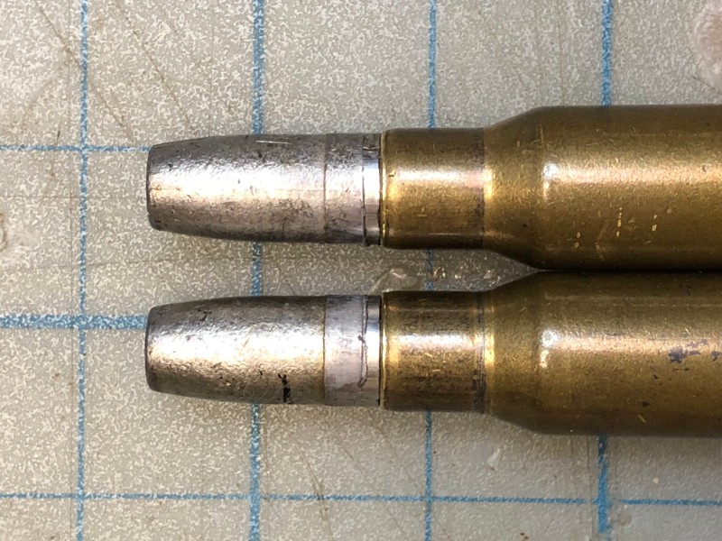

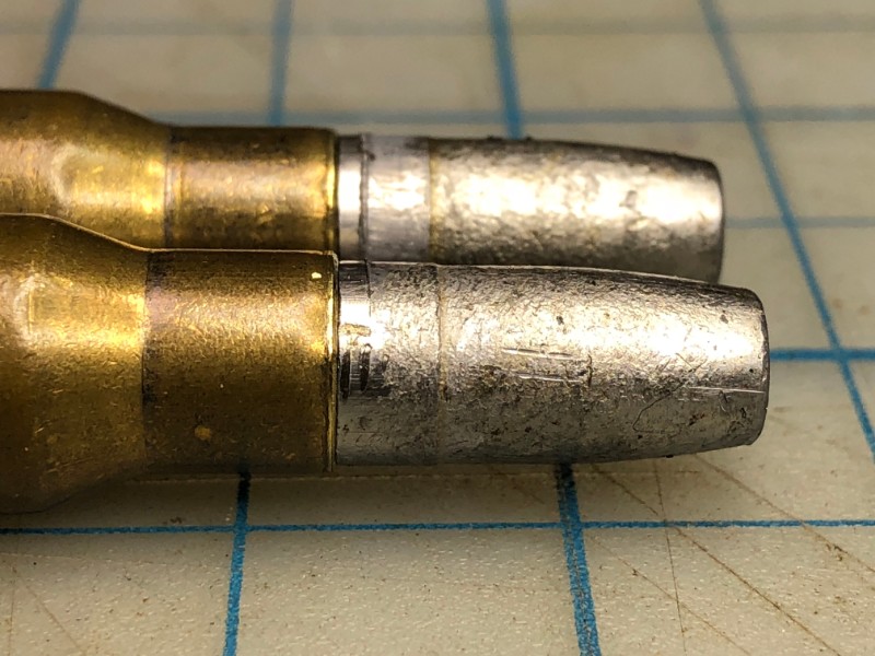

            I know it has been a while, but I finally start shooting with my Savage Model 10 308 using the TL310-180 NOE mold.
            Here is my rifle at the local range (also testing subsonic loads of 8.5gr and 9gr of Trail Boss):
            I initially size them to .310″, but when I closed the bold the bullet got stuck in the barrel.  I then got a new sizing die and size them to .309″, and although they don’t get stuck, they are very tight around the throat, and even to achieve that I have to seat them fairly “deep”, as you can see by these two I got out:
            Initial accuracy at 50 yards has not been bad but wanted to share my initial findings – perhaps my barrel has a “slightly” smaller throat area?
